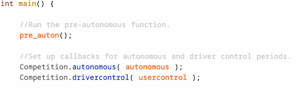

Step 2: Understand the three sections of the template
  • The competition template has three sections that correspond to the three phases of a competition match: robot setup, autonomous, and driver control.
  • In order for your code to work at a competition, you must leave this code in place and add your code inside the sections.

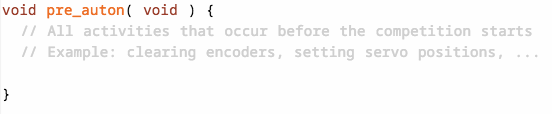

Step 3: Use a pre-autonomous routine for any setup steps
  • Add any setup steps such as gyro calibration, or other sensor resets that should run when the program is started, to the pre_auton function.
NOTE:  This code will run immediately when the program is started, before the autonomous portion of the match begins.
NOTE: You may not have any setup steps. If so, leave this section empty.

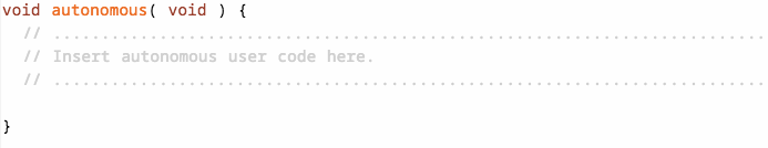

Step 4: Add your autonomous routine
  • Put the code for your autonomous routine into the autonomous function.
NOTE:  You can copy and paste this code from another program file.
